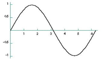

Take a simple one like the trigonometric sine function:
y = sin x
By plotting the value of the function for various values of x and connecting them smoothly, we obtain the curve shown in Figure 2.
Figure
Figure 2. Plot of sine function values

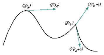

We all know (or think we do) what a nice, smooth curve looks like: it has no kinks or corners. If we were to sit on that moving point as it traces out a parametric curve, we would experience a nice smooth ride with no stopping, restarting, or sudden changes in speed or direction. This intuitive notion can be expressed in precise mathematical terms: Imagine an arrow that always points in the direction in which our hypothetical point is traveling as it moves along the curve. Mathematically, the direction arrow corresponds to the tangent of the curve, which can be computed as the derivative of the curve’s defining function with respect to the time parameter t:
Q’(t)
In Figure 3, for example, the point on the curve corresponding to time tA is labeled as Q(tA), and the direction vector (tangent) at that point as Q’(tA). If the tangent does not jump suddenly from one direction to another, the curve’s function is said to have first-derivative continuity, denoted by C1. This corresponds to our intuitive notion of smoothness.
Figure
Figure 3. Tangent (derivative) of a spline
Now look at the point marked Q(tB), where there is a visible kink in the curve. The direction vector just a tiny bit to the left of that point, Q’(tB- a), is wildly different from the one just a tiny bit to the right, Q’(tB+a). In fact, the direction vector jumps instantaneously from one direction to another at point Q(tB). Mathematically, this is called a discontinuity.
Many of you will hopefully recall from your calculus that the derivative of a function is also a function, whose degree is one less than that of the original function. For example, the derivative of a fourth-degree function is a third-degree function. The derivative of the derivative, called the second derivative, will then be of degree 2. This second derivative may or may not be continuous: if it is, we say that the original function has second-derivative continuity, or C2. As the first derivative describes the direction of the curve, the second derivative describes how fast that direction is changing. The second derivative therefore, characterizes the curve’s degree of curvature, and so a C2-continuous curve is said to have curvature continuity. (WHEW!) We’ll come back to these important concepts after we’ve introduced NURBS themselves.

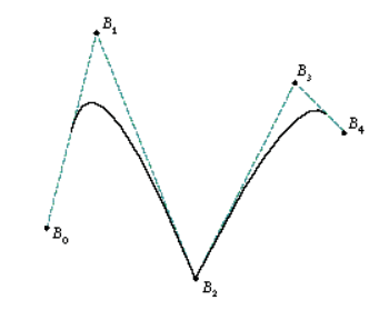

One of the key characteristics of NURBS is that their shape is determined by (among other things) the positions of a set of points called control points, like the ones labeled Bi in Figure 5. As in the figure, the control points are often joined with connecting lines to make them easier to see and to clarify their relationship to the curve. These connecting lines form what’s known as a control polygon. (It would actually make more sense to call it a "control polyline," but the other is the conventional term.)
FigureFigure
Figure 5. Defining a curve with control points

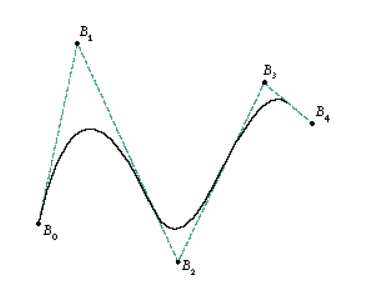

The second curve in Figure 5 is the same curve, but with one of the control points (B7) moved a bit. Notice that the curve’s shape is not changed throughout its entire length, but only in a small area near the changed control point. This is a very desirable property, since it allows us to make localized changes by moving individual control points, without affecting the overall shape of the curve. Each control point influences the part of the curve nearest to it but has little or no effect on parts of the curve that are farther away.
One way to think about this is to consider how much influence each of the control points has over the path of our moving point at each instant of time. At any time t, the point will be a weighted average of all the control points, but with the control points closer to the point carrying more weight than those farther away. We can express this intuitive notion mathematically this way:

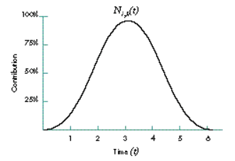

Figure 6 shows a typical example of what a basis function might look like: it has its maximum effect at some definite point in time and tapers off smoothly as it gets farther away from that point. If you were awake during your statistics course, you might recognize this as the familiar "bell curve" that we all learned to know and despise. The curve Ni,k(t) in the figure shows that control point Bi has its greatest effect (about 95%) at time t = 3.0 and tapers off to about 50% at t = 1.7 and t = 4.3.
Figure
Figure 6. Basis function for a control point

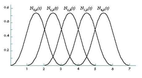

Since each control point has its own basis function, a spline with, say, five control points will have five such functions, each covering some region of the curve (that is, some interval of time). At time t = 2.3 in Figure 7, for example, control point B0 has a weight of about 0.2, B1 about 0.7, and B2 about 0.05. As t goes from 0.0 to 7.0, each control point’s effect on the shape of the curve is initially 0, increases gradually to a maximum, and then gradually tapers off again to 0 as we reach the end of its effective range.
Figure
Figure 7. Uniform basis functions for a set of control points
Knots
Notice that all of the basis functions in Figure 7 have exactly the same shape and cover equal intervals of time. In general, we would like to be able to vary the width of the intervals (so that some control points affect a larger region of the curve and others a smaller region) and the maximum height of the curves (so that some control points affect the shape of the curve more strongly than others). This is where the NU in NURBS comes from: it stands for Non-Uniform.

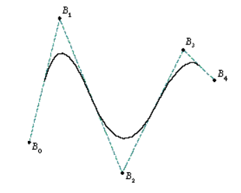

Figure 9. NURBS curve with uniform knot vector

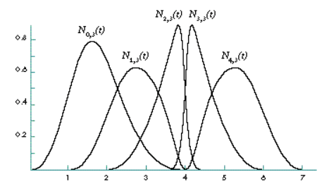

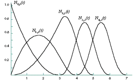

If we change the knot vector to {0.0, 1.0, 2.0, 3.75, 4.0, 4.25, 6.0, 7.0}, we get a set of nonuniform basis functions like the ones shown in Figure 10, and a curve that looks like Figure 11 (using the same set of control points as in Figure 9). Notice that the basis functions N2,3(t) and N3,3(t), associated with control points B2 and B3, respectively, are taller and narrower than the others. If you compare Figures 9 and 11, you will see that the curve in Figure 11 is pulled more strongly toward control points B2 and B3 than the one in Figure 9. This is because the basis functions for these control points have a greater maximum value. Also, the curve rapidly approaches these control points and rapidly moves away: compare how tightly curved it is near these points, relative to the curve in Figure 9. This is a result of the narrower basis functions for these two control points: intuitively, our moving point has to traverse more space in relatively less time. Looking at the knot vector, you can see that the knot intervals for these two control points are narrower than the others — {3.75, 4.0} and {4.0, 4.25} — meaning that their effects on the curve are concentrated in shorter time intervals.
Figure
Figure 10. Non-Uniform basis functions for a set of control points

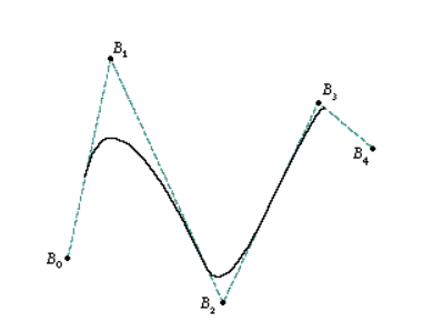

We can accomplish both of these goals by using a rather extreme case of non-uniformity: giving several consecutive knots the same value of t. For example, a knot vector like {0.0, 0.0, 0.0, 3.0, 4.0, 5.0, 6.0, 7.0} produces a set of basis functions like those in Figure 12 and a curve (using the same control points as before) that looks like Figure 13. Looking at Figure 12, you can see that at t = 0, the basis functions associated with all but the first control point have a 0 value — so basis function N0,3(t) (the one for control point B0) has total control over the curve. Thus the curve at t = 0 coincides with the first control point.
Figure
Figure 12. Basis functions for a curve with multiple identical knots at the beginning
Figure
Figure 13. NURBS curve with multiple identical knots at the beginning

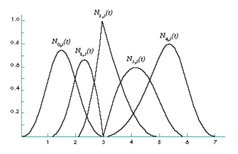

If we bunch up some knots in the middle of the knot vector {0.0, 1.0, 2.0, 3.0, 3.0, 5.0, 6.0, 7.0}, we get the basis functions shown in Figure 14 and the curve in Figure 15. At t = 3.0, all the basis functions except N2,3(t) have a 0 value — so control point B2 is the only one to affect the curve at that instant, and thus the curve coincides with that control point.
Figure
Figure 14. Basis functions for a curve with multiple identical knots in the middle

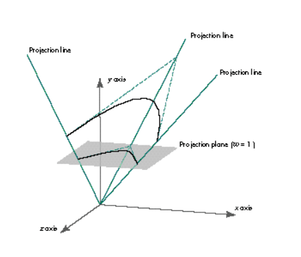

If you have seen CAD/CAM NURBS definitions, you may have wondered why it uses a four-dimensional representation for three-dimensional control points: {x, y, z, w} instead of just {x, y, z}. The reason for the extra coordinate is that it allows us to exactly represent conic curves (circles, ellipses, parabolas, and hyperbolas), as well as giving us more control over the shape of other curves. The fourth coordinate, w, is customarily referred to as the weight of the control point. Ordinarily, each control point carries a weight of 1.0, meaning that they all have equal influence on the shape of the curve. Increasing the weight of an individual control point gives it more influence and has the effect of "pulling" the curve toward that point (see Figure 16).
Figure
Figure 16. Increasing the weight of a control point
Curves that are defined in this way, with a weight w for each control point, are called rational curves. Mathematically, such curves are defined in four-dimensional space (since the control points have four components) and are projected down into three-dimensional space. Visualizing objects in four dimensions is a bit difficult (let alone drawing them in a diagram), but we can understand the basic idea by considering rational two-dimensional curves: that is, curves defined in three-dimensional space and projected onto a plane, as shown in Figure 17.
Figure
Figure 17. Projecting a three-dimensional curve into two dimensions
This is essentially the same process as projecting a three-dimensional model onto a two-dimensional screen with perspective. The basic method for such perspective projection is to divide by the homogeneous component of the vertex (that is, w); we use an analogous approach to project our four-dimensional rational curve into three-dimensional space. Mathematically, then, we must incorporate this division into our earlier definition for a B-spline curve:
Formula
The Bi are the projections of the four-dimensional control points and the wi are their weights.

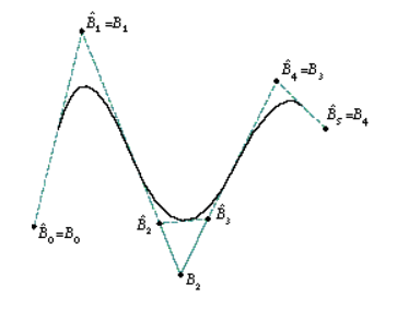

Figure
Figure 18. Inserting a knot
This operation of knot insertion is a fundamental one in working with NURBS curves. It is directly useful in both modifying and rendering curves.
