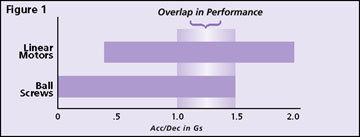

Overlap in Performance
There is also an overlap in performance between the two technologies (see figure one). Acceleration rates and achievable thrust of high-performance ballscrew systems match linear motor rates in some cases. Ballscrew systems are available with specs from .1 g to 1.4 g specs and linear motors typically accelerate at rates of 1 g to 2 g.
Regardless of whether ballscrews or linear motors are used in an application, core cooling is essential. Without linear motor core cooling or chilled ballscrews, thermal growth can be problematic. If linear motors are not core cooled effectively, the bed and column are impacted, affecting static alignments and volumetric accuracies. Without proper ballscrew cooling, thermal displacement causes linear growth of the screw.
