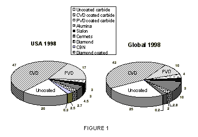

FIGURE 1 shows the estimated usage of the main cutting tool materials in use today in the USA and on a global basis.
