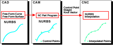

GE Fanuc diagram
As GE Fanuc points out with this diagram, curve interpolation changes the fundamental approach to contouring program preparation and execution.
The better solution is for the CNC to interpolate directly from the true curves generated in CAM, and that’s what GE Fanuc is after with their NURBS interpolation feature. With it, the control reads a very different G-code than that to which machine shops are currently familiar. Rather than the X-Y-Z coordinates of aconventional program block, the NURBS data includes the control points, weights, and knotvectors required to define the curve. The control builder contends that this method of representing curved cutter paths "results in a reduction of program size of 1/10th to 1/100th of a comparable linear interpolation part program and significantly improves the fundamental accuracy issues."
