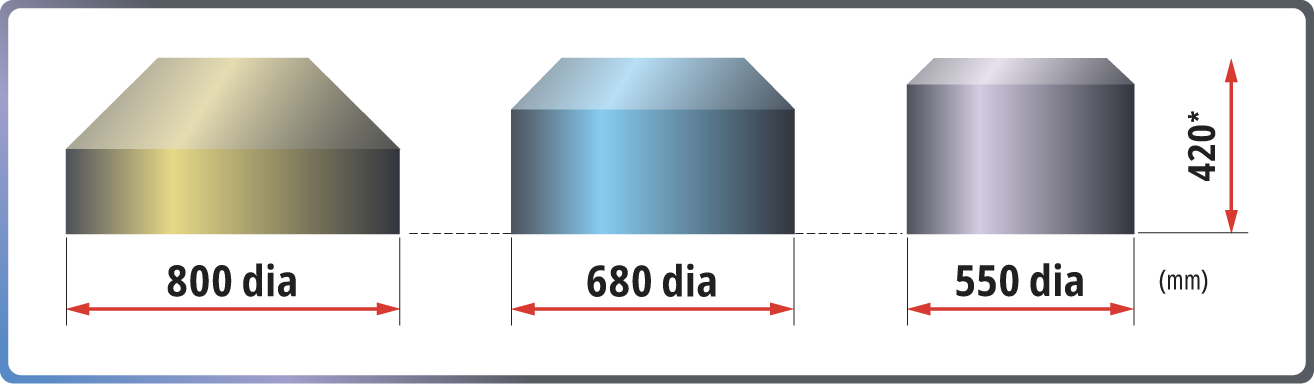

Maximum Workpiece Size (diameter × height) 800 × 420 mm (with limitations)
