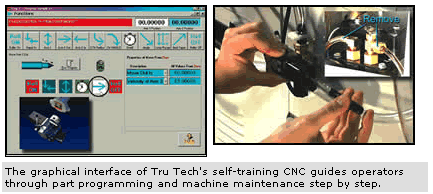

Within the past 3 years, the company purchased eight CNC grinding centers manufactured by Tru Tech Systems (Mt. Clemens, Michigan), and four more machines were ordered in May. Some of these machines are standard OD grinders and some are three-axis OD grinders. For greater efficiency in maintaining wheel geometry and surfaces, the machines incorporate on-board dressing attachments. Correct dressing routines are specified by the CNC that runs Tru Tech’s Pick-N-Place software. This user-friendly program combines the functions of conventional training and maintenance manuals. The program employs a talking British character that prompts the operator through each stage of setup, production and machine maintenance. It also incorporates on-screen calculators for trigonometry and radius problems.
Provided that new employees have some basic computer and math skills, they can be trained to operate these grinders in a matter of hours. This represents an important advantage for a shop that aims to be globally competitive. “Typically, each of our trained operators is operating two or three machines at once,” says Mr. Sutton. While previous experience in metalworking is certainly desirable for new shop personnel, it’s not required. For example, one of the shop’s current employees, who learned to operate this system in only a day, formerly worked in an auto parts store.

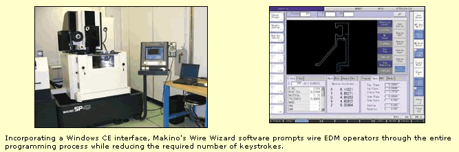

Recognizing that the conventional CNC interface presents a roadblock in the learning curve, Makino (Mason, Ohio) accepted the task of designing a new type of control program for its wire EDM products. The culmination of this work is Wire Wizard software that soon will be integrated into the MGW-S controls on the company’s complete line of wire EDM machines.
Instead of requiring operators to master operational routines unique to specific CNCs, this program employs a Windows CE graphical interface that prompts the operator step-by-step through the entire programming process by using on-screen pointers. If the operator makes an error, the software immediately displays an alert pinpointing the nature of the problem. This eliminates the need for new operators to stop and think about what to do next, or to refer back to their CNC manuals.
The Wire Wizard was developed in the United States primarily to address the needs of the American market. Makino’s principal goals were to create a more rational control and to reduce the total number of keystrokes necessary to input part programs. Whether programming at the machine or inputting programs from various CAM systems, the software meets these objectives very effectively. With this capability, shops may assign less-experienced personnel to operate the machines while experienced programmers are creating and verifying part programs. This substantially improves labor efficiency, thus enabling manufacturers to compete more aggressively in a global economy.
