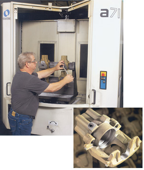

Operator sets up ductile iron brake calipers for machining on META Mfg.’s Makino a71 HMC. Caliper production requires 33 operations, including milling, drilling and boring.

The new requirements resulted in development of new processes and technology acquisitions. According to operations engineer Bob Strunk, the machines META was using for the ductile iron brake calipers were not removing metal at a fast enough rate. And, their lack of rigidity resulted in vibration and chatter in the two-operation, 33-tool machining process.
META found the production solution to this challenge in the a71 horizontal machining center from Makino (Mason, OH). "Makino took care of both of those problems," says Strunk. "The Pro3 controller and a71 design allowed us to better manage our workload and get closer to the part due to the deep Z-axis movement. This allows me to use shorter tools, which, along with Makino’s rigid construction, eliminates vibration and chatter. With the high-speed spindle, this improves our speeds and feeds and increases tool life.
Strunk says the machine reduced time in and out of cut, improved quality, and freed up labor, allowing a single operator to run the machine and perform additional tasks. "And, most importantly for JIT work, we have had no downtime on the machine at all in nearly one year," he adds.
