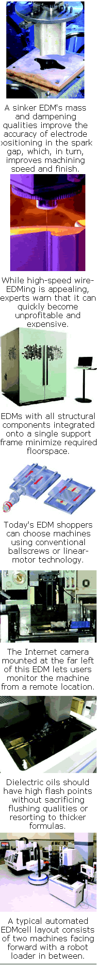

Fast jump, or cycling speeds, and quick servo acceleration over small distances on today’s diesinking EDMs demand a rigid, vibrationdampening machine design, says John Shanahan, product manager at Makino. These faster speeds generate more friction and heat, so shops should look at the size and containment of a machine’s ballscrews and linear guides, along with their overall mass.
"Ballscrews with recirculating ball bearings and double-nut construction supported at both ends maintain necessary rigidity for increased machine speeds," points out Don Moulton, a regional sales manager for Ona America. Another important consideration EDM shoppers face is whether to choose machines using conventional ballscrews or linear-motor technology. Linear motors, whether incorporated into sinker or wire EDMs, provide several benefits. They simplify machine design by eliminating moving parts, ballscrews and couplings (so there’s no backlash), and metal-tometal contact. They provide smooth, vibration-free movement, high axis speeds and accelerations, and accuracy and repeatability when paired with linear glass scales.
When it comes to machine speed, Naughton says shoppers should think in terms of " realworld" cutting speed. "There are a lot of inflated speed claims, and shoppers can easily wade through them by simply having the OEM demonstrate a machine’s top cutting speed (without wire breakage) for 1 or 2-in. D2 material using 0.010-in.-diameter brass wire." While high-speed EDMing is appealing, Makino’s Shanahan warns that it can quickly become unprofitable and expensive. "If a shop is planning to use 0.0130.014-in.-diameter special brand-X wire to cut at a machine’s advertised speed, it had better make certain that the cost of those speeds is worth it in terms of overall production value."
If high speed is the choice, he suggests a machine with a rigid mechanical structure that withstands higher-than-normal flushing pressures associated with high-speed EDMing. High flushing pressures can deflect a machine’s upper and lower heads, causing a poor-quality roughing pass. This increases the number of necessary finishing passes and, thus, reduces the initial advantages of high-speed cutting.
Shanahan adds that "shorter cycle times are only advantageous if maintaining operating efficiencies. Highspeed EDMing can cost as much as 2 or 3 that of normal operating cost. For instance, large-diameter wire costs more per pound and runs out faster than standard sizes. In some cases, shops lose profits because of the increase in consumables." With this in mind, he suggests wire-EDM buyers demand an estimate of the recommended consumables, spare-parts cost, and maintenance intervals based on machining at high speeds — and hold the OEM responsible for the accuracy of its estimate.
On the sinker side, Shanahan says that a machine’s mass and dampening qualities improve the accuracy of electrode positioning in the spark gap, which, in turn, improves machining speed and finish.

Most OEMs offer off-line control access through standard ethernet connections. This lets users not only monitor and run the machine from a remote location but also tap into local applications and service agents for real-time support.

For sinker EDMs, shops should consider running dielectric oils that have high flash points without sacrificing flushing qualities or resorting to a thicker formula. OEMs recommend shoppers consider food-grade oils that improve flushing, contain no chlorinated solvents, and are colorless and odorless. They also deliver high dielectric strength to reduce recast layers on part surfaces.

How easy is it to incorporate a machine into workcells supported by robotic systems, and does it run as either a master or slave? These questions, according to Mitsubishi’s Langenhorst, are the first ones customers should ask when considering automation along with their EDM purchase. And to ensure the automation system is reliable, shoppers may want to consult EDM OEMs that team up with automationequipment manufacturers.
On some EDMs, controls can be moved to accommodate different automated-cell layouts. Locating controls on the left-hand side of a machine, for instance, allows for a cell layout consisting of two machines facing forward with a robot loader in between, which makes cell operation easy and conserves floorspace.
Besides the EDM, most cells typically include a changer robot and magazine units. Changer robots load and unload electrodes and workpieces in and out of machines. Magazines, which are usually bookshelf or revolving type, store both electrodes and workpiece setups/pallets.
Most automation experts recommend modular magazines that let shops start out small and add units as workloads increase. They also suggest workholding systems that make it possible to fixture parts/electrodes once and pass them from one machine to the next.

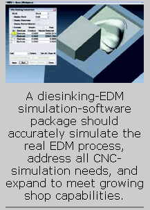

Simulation software
A diesinking-EDM simulation-software package should accurately simulate the real EDM process, address all CNC-simulation needs, and expand to meet growing shop capabilities.Makino EDM
When shopping for a diesinking-EDM simulationsoftware package, shops should ensure the package accurately simulates the real EDM process, addresses all CNC-simulation needs, and expands to meet growing shop capabilities.
Tooling manufactures shopping for simulation software should ask a couple of questions, states Jeff Werner, marketing communications director for CG Tech. Can the software perform multi-axis operations, support multiple setups, and simulate complex tool shapes? Also, does it model fixtures and holders and accurately simulate the control’s specific M and G codes and all control features used in programs?
Another factor to consider is the software’s ability to go beyond a simple visual check. It should provide accurate in-depth model analysis, automatically detect gouges and excess material left on parts, and simulate each of a shop’s machine tools for collision checking. And most importantly, emphasizes Werner, the same control logic that drives the real machines must drive simulations.
