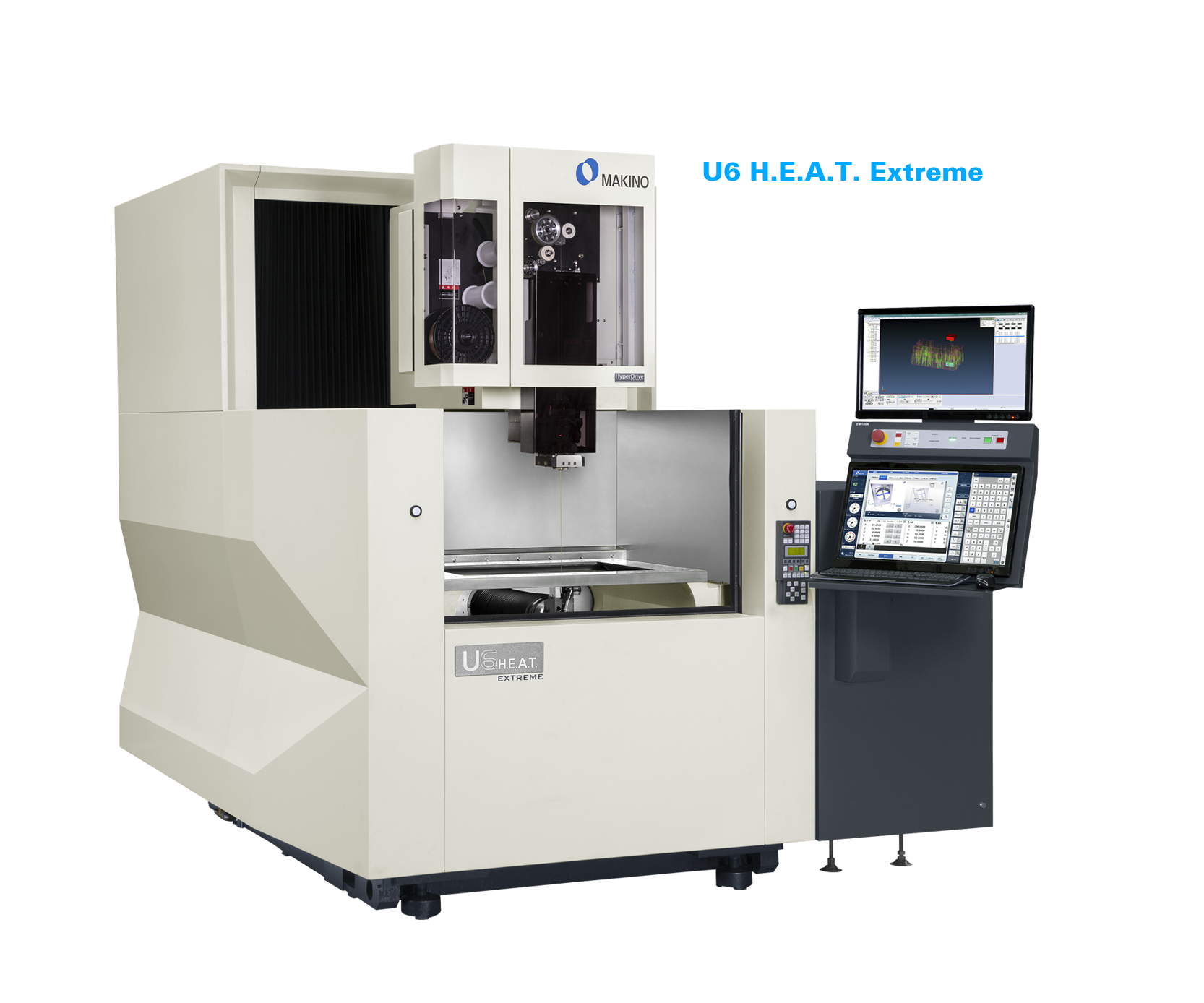

Double cutting speed without increasing wire consumption with our latest wire EDM model. Makino is the world leader in wire EDM, giving you faster processing times and superior surface finishes for even the most complex part geometries.
wire edm page extreme
Half the Wire – Half your Cost
Most wire EDM machines chew through more than one pound of wire per hour, making wire consumption the biggest expense of operating a wire EDM. Makino wire EDM machine uses half that, providing a significant long-term savings in $1,000’s of dollars per year in operating cost.
The wire consumption unspool speed on a Makino wire EDM is set to a constant low rate where optimal machining speeds can be maintained without the wire breaking.  Makino has also developed a unique adaptive control technology called BellyWIZARD which automatically compensates and adjusts the wire mechanically based on work piece thickness to ensure the best part straightness and precision while incorporating the advanced HyperDrive wire transport and tensioning system.
Our wire EDM machines utilize a unique fully digital dual flush pump configuration that provides automatic dynamic adaptive control of flushing to the Upper and Lower machine heads in real-time during operation.  This intelligent and highly effective configuration provides double the horsepower in flushing capacity and ensures that the necessary flush is applied optimally to when and where it is needed for best performance and productivity.
Other Makino wire EDM machining advantages include:
  • Up to 50% less maintenance, which is a critical benefit compared to the usual high-maintenance requirements associated with wire EDM production. Makino wire EDM machines also have less consumable wear parts.
  • Large HD Touchscreen control that works like a smartphone. Operators of all skill levels can use this streamlined interface that reduces machine training requirements.  Only Makino can provide the advanced Hyper-i control that provides an identical productive interface for all Makino wire EDM, Sinker EDM, and EDM Drilling machines, which further reduces training support needs.
  • Easy automation. Get predetermined optimized settings for any application and 24/7 production with no attendant required.
