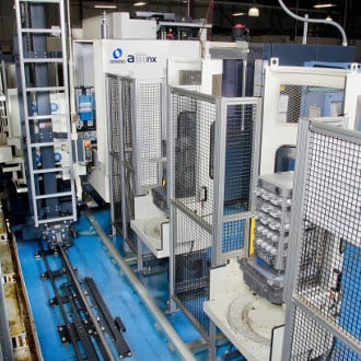

			   •  A Makino a51nx horizontal machining center
			   •  A 12-pallet MMC2 material handling system
			Makino handled all aspects of design and installation. AFAB personnel traveled to Makino’s Mason, Ohio, facility for training prior to installation of the flexible manufacturing system. Not long after the cell was in place, a Makino representative visited AFAB and provided a list of recommendations to further enhance performance.
			With the a51nx and MMC2 system, AFAB has been able to achieve 100 percent utilization rates, or 22-plus hours of production each day. The company has cut cycle times to almost half of what they used to be, and has regularly achieved tolerances to the required 0.0002 inch specifications, thanks to the construction and features of the a51nx.
			A medical lamp base that previously took 17 minutes for the first operation now is reduced to just eight minutes. AFAB estimates that eliminating repeat setups through the flexible manufacturing system is saving the company at least $100,000 per year.
