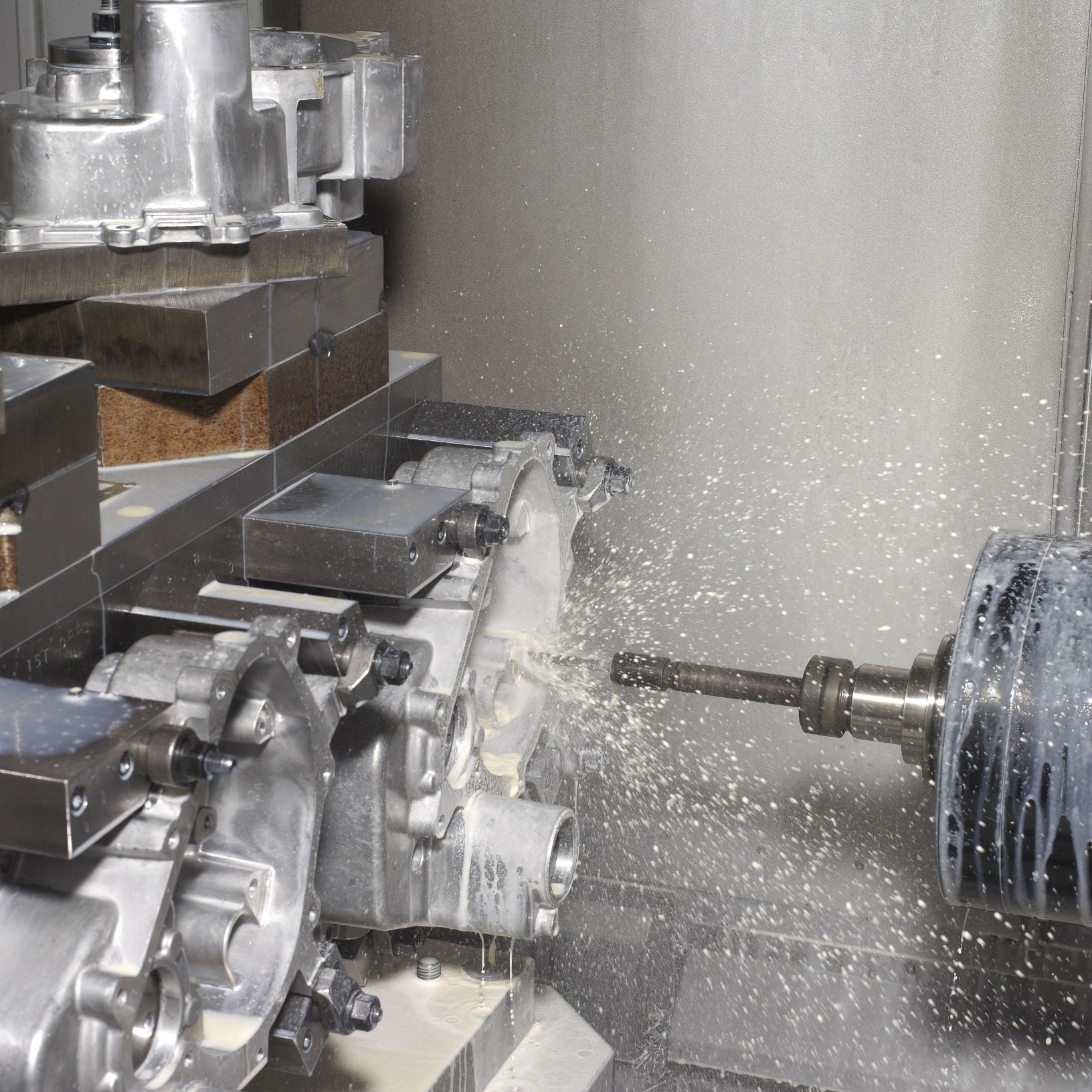

To handle its large production parts, Covert invested in 20 Makino A88E horizontal machining centers for their large work zone, rigidity and capability in handling large tools. The company applies the machines to a variety of mixed engine parts ranging from 3 to 100 pounds. Additionally, Covert recognized the A88E’s wide-ranging spindle capability as the ideal solution for cutting a variety of materials noted below:

With the A88E machines, Covert can now produce large orders of up to 50,000 parts within short lead-times. The machine’s inherent rigidity enables the company to perform accurate machining along all axis extremities, providing for precision across all part features in any size application.
Using the flexibility and overall tooling capacity (130 tools) of the A88E, Covert has been able to perform more processes in a single setup, minimizing machine downtime and stack-up error. In one engine component application, the company used over 40 tools in three phases on the same pallet. Processes included deep-hole drilling, high-feed face milling and 0.0005-inch diameter tolerance boring. Part probes were implemented between phases to verify feature accuracies and locations.
