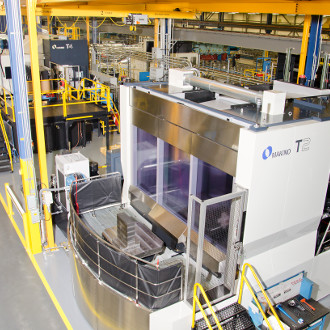

Titanium’s unique properties make the hard metal challenging to machine cost-effectively. Nevertheless, ATEP Laval identified titanium-engineered products as a significant growth market. The problem was that general-purpose machine platforms were unable to provide the rigidity, flexibility or control necessary to fully optimize ATEP Laval’s processes, so it sought new titanium machining technologies.
Due to the company’s previous experience with several Makino MAG-Series machines for large aluminum aircraft structural components, it decided to explore Makino further when looking for a titanium machining solution. The company invested in a Makino T4 5-axis horizontal machining center, which is purpose-built for titanium machining. Engineers from ATEP Laval closely evaluated full life-cycle costs amortized over the duration of an OEM contract. Through test-cut results, it determined that the T4 was the best investment to offset costs while maintaining requirements for quality and delivery.
ATEP Laval and Makino engineers worked side by side to optimize processing methods that are nearly three times faster than the company’s previous methods. This collaboration with Makino’s titanium research and development team gave ATEP Laval confidence in the abilities of the equipment to deliver on the promise of performance that was made to customers.
The T4 machines have enabled Alcoa’s ATEP Laval facility to reduce cycle times by more than 60 percent while simultaneously reducing tool costs by 30 percent or more.
