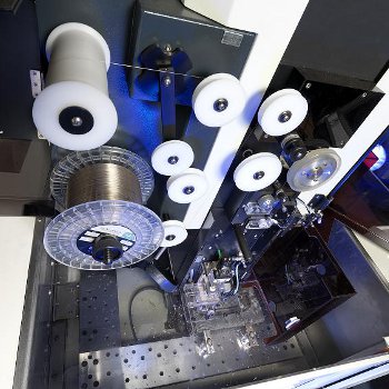

Some of the company’s employees had previous experience with Makino machines, which led Master Cut to invest in a Makino U86 wire EDM machine to handle a variety of part sizes, especially larger parts.
Master Cut also needed a smaller machine with round guides for the small holes it wanted to thread, so the company purchased a Makino DUO43 wire EDM machine for high-precision small holes.

The user-friendly U86 enabled Master Cut to machine a 4,500-pound block with a 20-inch tall cut and tolerance of 0.0002 inches on the first run during the first day. It had tight, consistent accuracies on even its largest orders.
With the DUO43, Master Cut machined a part against its previous machine, and it took less than half of the time—going from 360 minutes to 170 minutes.
Similarly, it needed to produce a cell phone part requiring 23 holes of 0.023-inch diameter. The popped holes started at 0.015 inches, making threading a concern. The DUO43 finished the job without a misthread, and with unprecedented accuracy.
The machine’s speed, agility and repeatability decreased cycle times by as much as 60 percent. The fast cycle times and excellent finishing, which have eliminated manual work, helped Master Cut take on tight-margin jobs while still turning a profit. In fact, the DUO43 has turned out to be the most productive machine in the company’s shop.
With the DUO43, Master Cut is using half as much wire as it previously used. When parts are finishing faster, that also equates to additional reduced wire usage. In fact, Master Cut estimates it saved about $26,000 in wire alone during its first year with the Makino machines.
