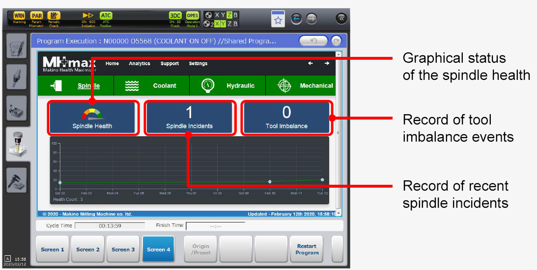

| Spindle Health
 | Spindle Health
Accelerometers are used to monitor spindle bearing frequency and this data is fed into the proprietary AI software developed by Makino. The software analyzes the data and determines the current health of the spindle which is indicated by a red/yellow/green gauge. In addition, a determination is made if the spindle has experienced an abnormal deceleration or "wreck" which potentially has damaged the spindle. Lastly, the sensors monitor whether a cutting tool is showing signs of imbalance while in the spindle. All of this is reported on a Spindle Health monitoring page.

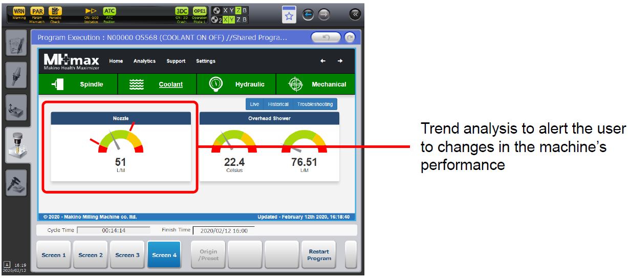

| Coolant System Monitoring
Flow rate and temperature gauges are used to monitor the machine's overhead shower and nozzle coolant systems to make sure the pumps, valves, and overall delivery system is functioning correctly. During the initial installation, a default setting establishes the acceptable range for the measurements based on Makino's analysis of historical data. As the machine runs in the shop with the operational parameters, the machine-learning software recognizes trends and adapts the acceptable range to allow for potential tighter control of these indicators. If a shop is running a critical process that has specific flow or temperature requirements, the system can be adjusted with user-controlled settings based on the known conditions.

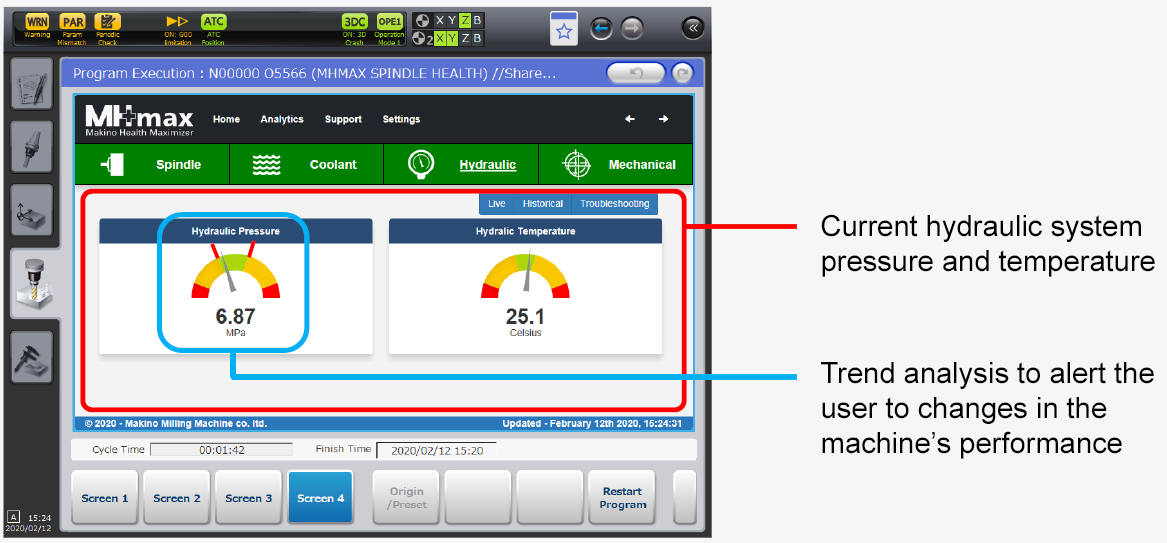

| Hydraulic System Monitoring
Pressure and temperature gauges monitor the machine hydraulic system that powers the APC (Automatic Pallet Changer) and certain aspects of the ATC (Automatic Tool Changer). Similar to the coolant monitoring system, the hydraulic system has initial default settings established for the pressure and temperature and will adapt over time to the trends that are analyzed through the software. These indicators will point to impending issues such as a clogged heat exchanger or solenoids sticking open and bleeding off.

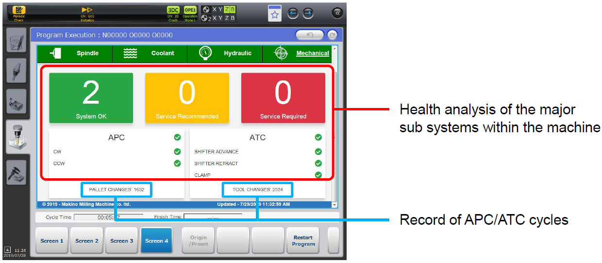

| Mechanical Systems Monitoring
The position timing of the clockwise and counterclockwise movement of the APC (Automatic Pallet Changer) is monitored to determine if it is operating out of the ordinary. In addition, the position timing of the shifter advance, shifter retract, and clamp of the ATC (Automatic Tool Changer) is observed to indicate potential issues. A view of the overall number of machine tool changes and pallet changes can be provided to inform users of the current "mileage" on these subsystems.

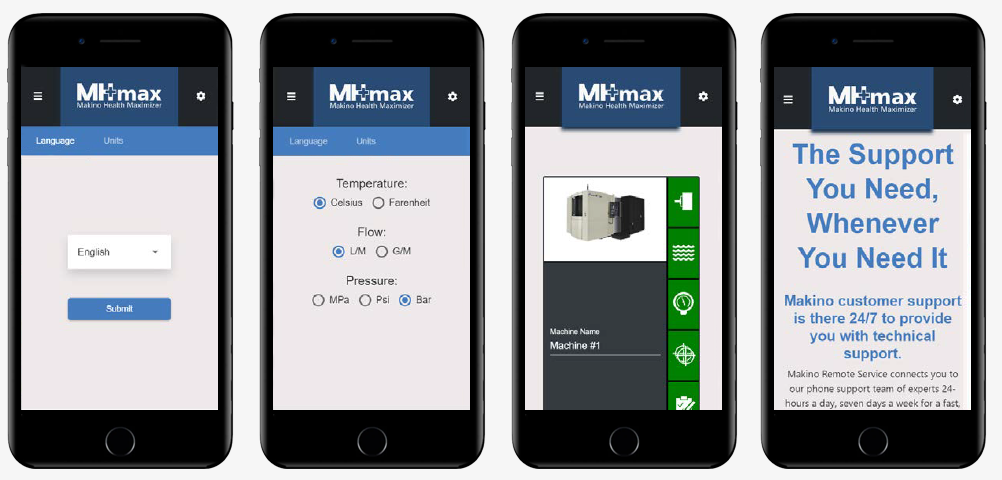

Level 3 connectivity also allows access to the dashboards through a mobile device.
