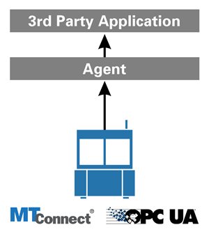

Makino machines with a Pro6 control already have the Adapter built into the machine. All that is required to enable this function is to turn on the parameter.
![](/getmedia/c37393f8-6e46-4928-a456-4c05931493e9/IOT-02.jpg?width=300&height=336)
The Agent software, along with the 3rd party machine-monitoring software, can be on a PC on the customer’s shop network that’s connected to the machines. When planning the network architecture, it is important to coordinate with the I.T. department to avoid network conflicts.

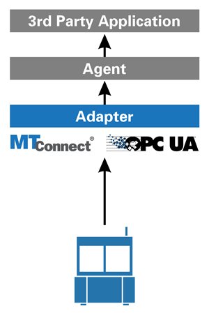

On Makino milling machines with older controls, the Adapter and Agent software are required to run on a PC.
![](/getmedia/5da288d9-4a32-478e-9c18-c65093de17e0/IOT-01.jpg?width=300&height=459)
This can be a DIN rail mounted PC within the machine tool electrical cabinet or another PC on the customer’s shop network. In addition, an ethernet connection is required on the machine tool which is common on modern machines. On legacy Makino machines manufactured around the year 2000 or earlier, the availability of an ethernet port should be researched based on the machine serial number.
