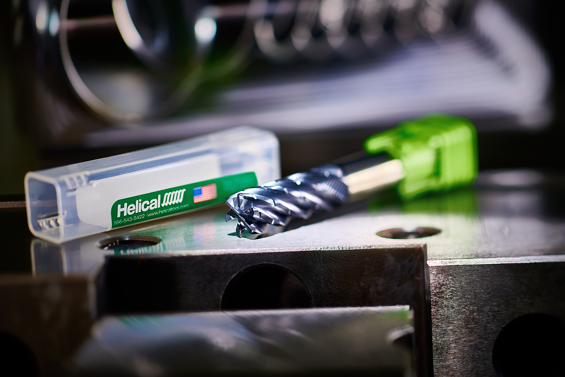

Several changes have occurred in the last 10 years to be able to better utilize high-speed machining of Molds and Dies. Practices and technology have changed in such a way that new ideas have been created and become mainstream in today's most competitive shops. Some of these ideas are roughing and semi finishing closer to zero stock combined with light and fast cuts when compared to the low and slow mentality of the past.
Starting with tooling enhancements, there has been a lot of development work around coatings. Almost all shops have made the transition into carbide tooling so the next piece to look at is the coating. Coatings enable the cutter to withstand heat, which can allow it to be pushed harder than an uncoated carbide cutter. The first key to successful HSM is that the cutter must be able to take the increased heat generation. From there, the chip created must have enough mass to be able to throw the heat away from the cut via the chip. Many of the top tooling suppliers have coatings that can work successfully in 65 HRc or higher! They continue to test new and innovative blends of coatings in order to further advance tooling limitations in even the most demanding applications.
![](/getmedia/93a614a0-ea2f-4b22-bb0e-dbbabba63fbf/Makino-AH-21-26037-LGuntitled.jpg)
Another often overlooked technology is the increase in tool accuracy. This relates to both size, form, and flute-to-flute repeatability. Just like in the machining world, cutter grinders and the metrology to check the cutters has improved over time. With better accuracy, it's possible to machine closer to zero and get the true form customers desire. The form of the tool is also crucial. When looking at a ball nose tool, if every point on the radius was the correct size, it would help to ensure the best form is going onto each part being machined, regardless of the contact point of the tool. Flute-to-flute repeatability is one of the keys to successful HSM practices. When pushing tooling to its limits, it's necessary to ensure that each flute is taking the amount of material that's anticipated. If one flute sticks out further than the others, that flute will fail prematurely and the machinist will not get the desired result.
One of the last tooling enhancements is the different tool designs. Yes, an endmill is an endmill. However, by adding more flutes, it can be run faster than previously. Manufacturers are making endmills now with 6, 7, and even 8 flutes! The machinist needs to pay attention to the additional flute designed cutters because some of them have deep flute gullets for softer material while more solid-core tools are specifically designed for harder metals. While this is not a novel idea, the barrel or lens design has begun to show up in increasingly more shops. This large radius tool enables machinists to take larger stepovers but still achieve the same finish as a smaller tool. The result, a much quicker cycle time in the right application. These cycle time reductions can be as high as 6 to 8 times faster or more! The larger cutting radius can also help with cutter life, enabling the machine to run for a longer period with less tool changes and edge breakdown.

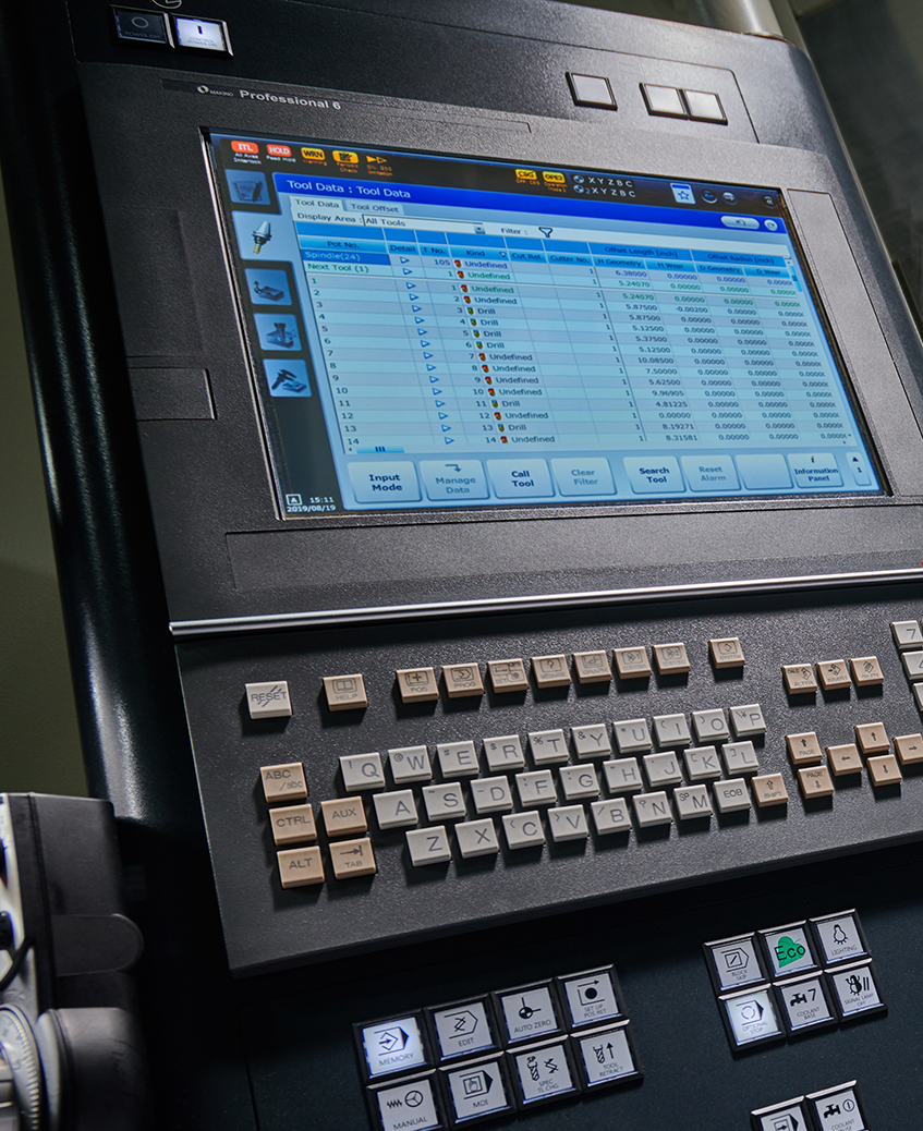

The machine tool's controller will also have a significant effect on HSM. The look-ahead technology must recognize when the machine can accelerate rapidly or if it needs to slow down in a corner in order to make an accurate move like is accomplished in Makino's Pro6 control with SGI.5 adaptive control. Much like a race car drivers' ability to navigate a road course, the controller needs to be aggressive when it can, and navigate slower and more carefully when making tight, accurate turns. Since HSM often calls for light and fast cuts, this look-ahead technology can dramatically slow down a tool path. If the CAM system estimates that a tool path should take 30 minutes, it typically does not include acceleration and deacceleration. The result isa longer cycle time once the part is run on the machine. A high-end machine tool controller will be able to navigate the g code easily and enable the machine tool to complete the toolpath as fast as the machine design allows.
Another major advancement with HSM is spindle load monitoring. Machinists are asked to push the machine and tooling to its limits, but what happens if something goes wrong? It only takes a small mistake to create a huge, costly fix. With spindle load monitoring, the machine will monitor the load on the spindle and can send an alert before any damage occurs. These alarms can be set to monitor excessive HP, torque, or force applied on the spindle and can help save the tooling as well as the spindle in the machine.

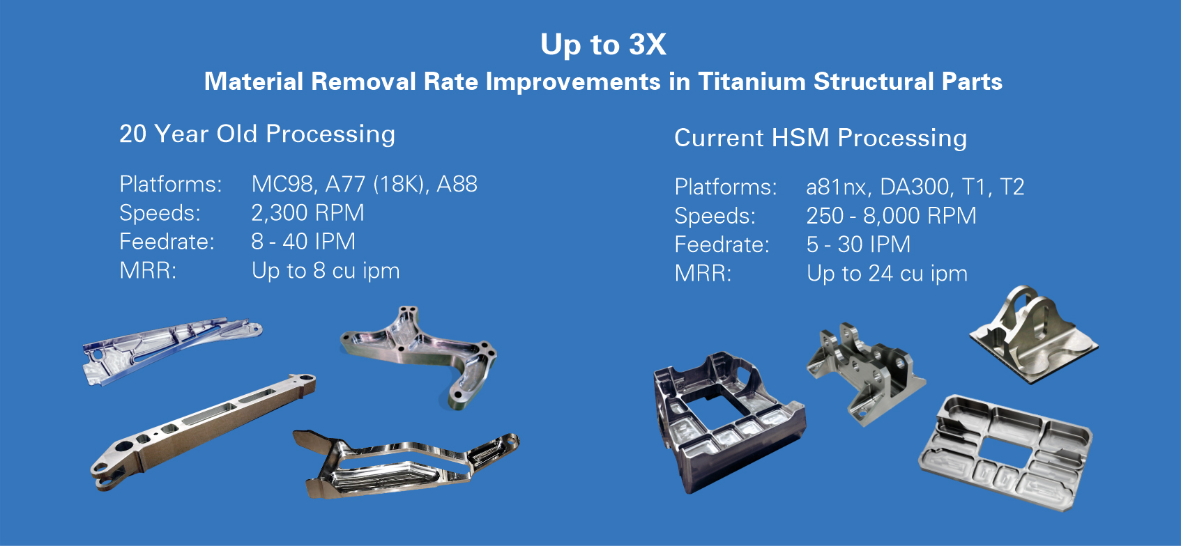

High-speed cutting techniques have been common within the Aerospace industry for very many years. Initially, these techniques were applied to aluminum parts; however, over time the same types of cutting approaches have been applied to other aerospace materials as well. “Go fast and take a light cut” applies to all these materials, the difference being what constitutes “fast.” Fast in titanium is dog slow in aluminum.
The development of high-speed machining has always been a “leap frog” series of product/process improvements between the machine tool builders and the cutting tool suppliers. As higher performance spindles became available, the cutting tool performance was often the limitation. As cutting tools improved, the spindle speed and power needs increased, causing new machine and spindle designs to become available. This sequence continues.
Today, Makino offers large, high-performance aluminum-focused machines with 33,000 rpm, 175 horsepower spindles and large titanium/hard-metal-focused machines with 4,000 rpm, 130 HP, 737 ft/lb spindles.
Smaller machine platforms may also be configured to provide high-speed machining capabilities for smaller parts.
Current process performance parameters as well as what was considered high speed aerospace processing 20 years ago are shown in the following examples:

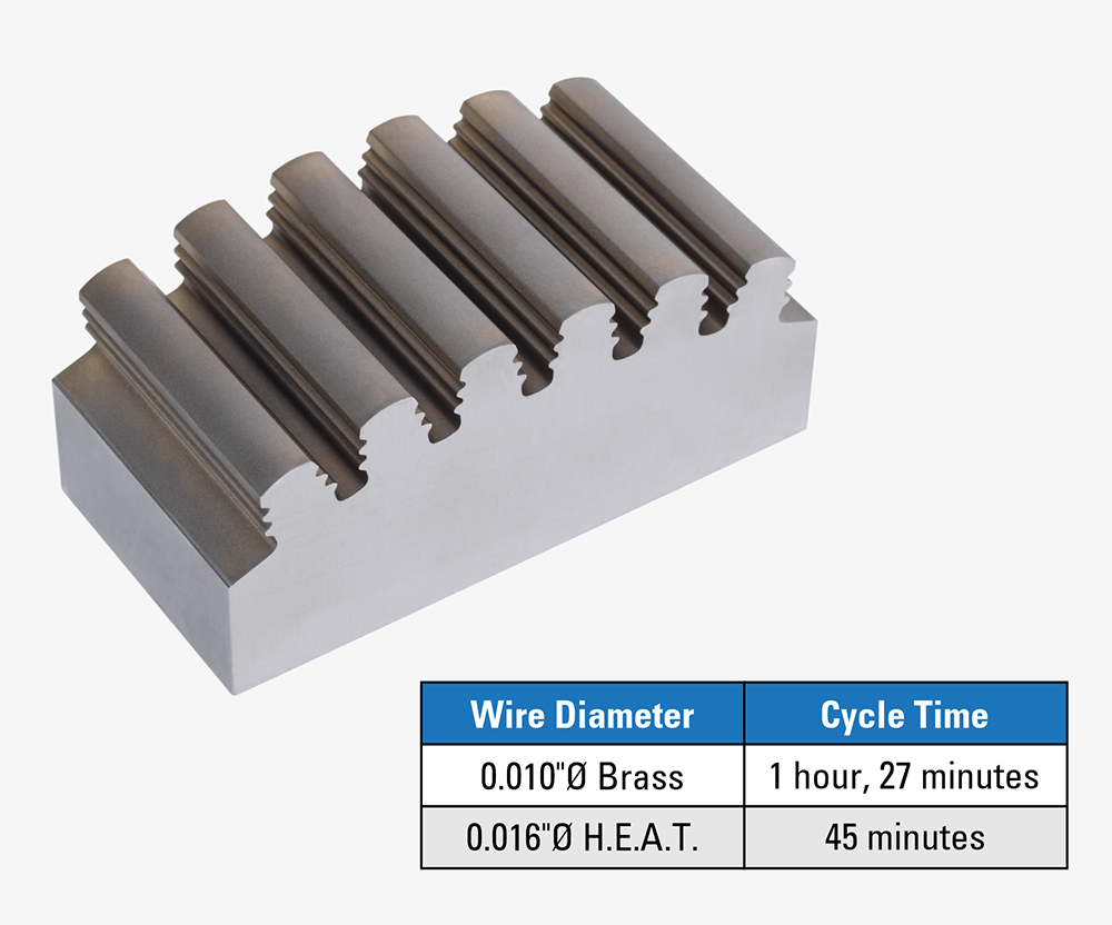

Example of a fir tree slot on a turbine disc being machined on a Makino HEAT Extreme Wire EDM at a 48% reduction in cycle time due to 1.9X faster machining speed.
