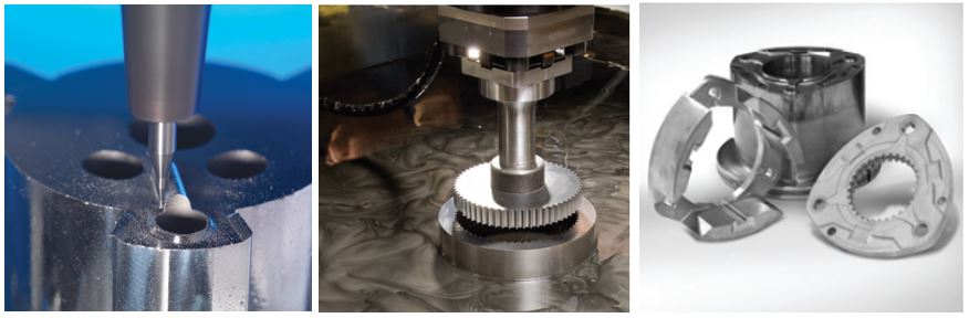

Little Lakes Machine & Tool of Stratford, Ontario, specializes in custom tooling for powdered metal parts. These tools are put under a lot more stress than typical molds and the materials are rated very high in hardness and abrasiveness. Most of the materials used in the company’s tools are between 55-65HRc—work that is not easily accomplished by most shops. The process is used to produce power transmission components, structural shapes and aerospace brackets.

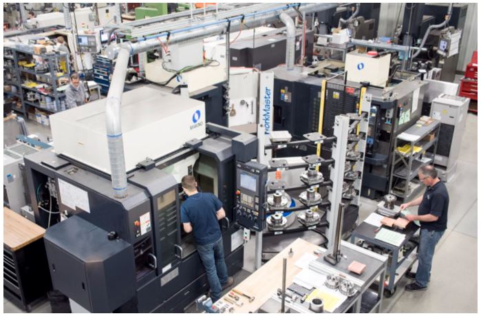

IMAGE SHOWN: A Makino V33i connected via a 20 station 3R Workmaster Robot Loader for 24/7 machining.
