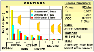

High speed tests run at ERC in hardened H13 steel demonstrated tool life performance of different insert geometries and coatings. Test parameters are listed to the right of the chart. Inset photos show examples of different coatings. |

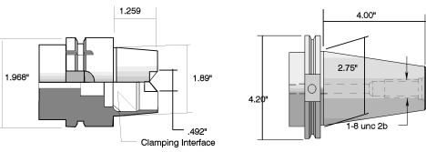

We’ll look at V-flange first. Regardless of the taper size, 30, 40, 50 or other, the V-taper or steep taper toolholder is pulled into the spindle bore by a draw bar or similar mechanism. The toolholder seats on a mating taper in the spindle. This system serves shops well, and probably a majority of machining center tools are of this design.
The HSK toolholder is designed to provide simultaneous fit on both the spindle face and the spindle taper. There are other hollow shank designs in addition to HSK. Common to all is the idea of two-plane fit between holder and machine spindle.
Equivalent toolholder sizes of HSK and V-taper. The difference in shank length is dramatic between the toolholder standards of 4 inches for the V-taper and 1.259 inches for the HSK. This illustration is courtesy of Dapra. |
Simultaneous fit is not exclusive to HSK. There are other designs, including one that is a steep taper, one that provides simultaneous spindle taper and one for face contact. In this case, two-plane contact is achieved by adding stock to the toolholder flange and spindle nose, effectively closing the 3 mm gap between the two surfaces and delivering a taper and face fit for V-taper tools.
High Speed Toolholders
At any speed, a machine tool spindle is subjected to centrifugal force. Centrifugal force increases geometrically as speed increases. This means if you double spindle speed, centrifugal force goes up by a factor of four.
At high speed, centrifugal force is strong enough to make the spindle bore grow slightly. Because V-flange tools contact the spindle bore only in the axial plane, spindle growth can cause the tool to be drawn up into the spindle by the constant pull of the drawbar. This can lead to a stuck tool or dimensional inaccuracy in the Z axis.
Simultaneous fit tooling has contact on the spindle face and taper. When this spindle begins to grow, the face contact prevents the tool from moving up the bore. The hollow shank design is also susceptible to centrifugal force but it is designed to grow with the spindle bore at very high speeds.
Rigidity is another touted advantage for simultaneous fit tooling. Supporting the cutting tool and holder in both the axial and radial planes makes a significantly more rigid connection between the tool and spindle.
Spindle face contact lowers the bending moment for the tool from inside the spindle bore to outside the bore on the face. It increases contact area giving better rigidity, which enables users to cut with longer tools and to use side-cutting milling tools more aggressively.
For high speed machining applications, the trend definitely points toward simultaneous fit, spindle tool interface as a requirement.

- Use multi-layer coatings. For cutting steel, use TiN, TiCN, TiN physical vapor deposition (PVD) over chemical vapor deposition (CVD). Performance of these coating combinations and application methods gives longer tool life with better heat transfer.
- In hardened steel, use inserts with a flat rake face. At the cutting speeds ERC is using, they have found a chip breaker unnecessary. A breaker used on a cutter at high speed in tool steel can weaken the cutting edge and increase wear on the cutter face.
