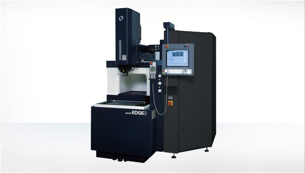

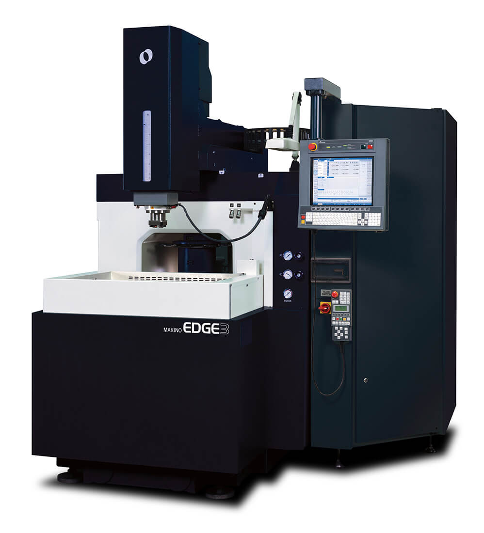

The EDGE-Series sinker EDMs feature an integral rise-and-fall work tank designed with excellent unobstructed access to the work zone for setups, which greatly improves visibility to monitor the machining processes. The machines include an eight-station automatic tool-changer (ATC) to extend unattended operation, and fully support robotic automation for greater unattended operations. The machines are equipped with critical safety features, such as flame sensor and fire extinguisher systems, that are integrated and monitored by the machine control. The footprint and work-tank specifications for the EDGE2 and EDGE3 are highlighted below.
  EDGE2  EDGE3
Footprint 1,750mm x 1,770mm x 2,300mm
(69" x 70" x 91", respectively)
1,950mm x 2,100mm x 2,300mm
(77" x 83" x 92", respectively)
Work Tank
(L x W x H)
650mm x 450mm x 300mm
(25.6" x 17.7" x 11.8", respectively)
800mm x 550mm x 350mm
(31.5" x 21.7" x 13.8", respectively)
