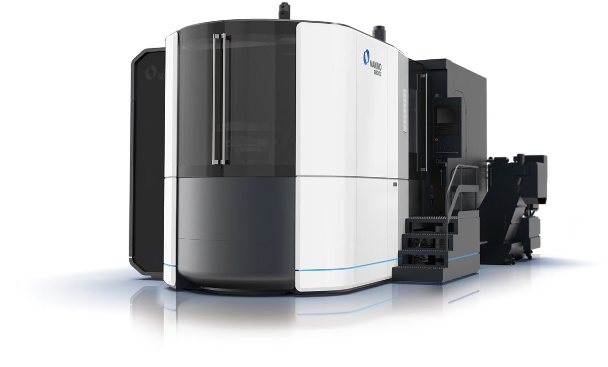

Makino takes five-axis horizontal machining to the next level with our a500Z. We offer:
  • High rigidity resulting from the a500Z’s unique double slant structure and true three-point leveling. Makino has developed multi-axis CNC milling machines that are highly productive, maximizing metal removal and minimizing perishable tooling costs.
  • High accuracy through integrated active temperature control, including ball screw core cooling, direct drive rotary axes cooling and spindle jacket cooling.
  • Automation ready with features promoting easy integration into direct robot load systems or Makino’s MMC2 pallet handling system. When integrated into an automated system, you can expect spindle utilization rates of up to 95%, and fully-unattended operation over nights and weekends.

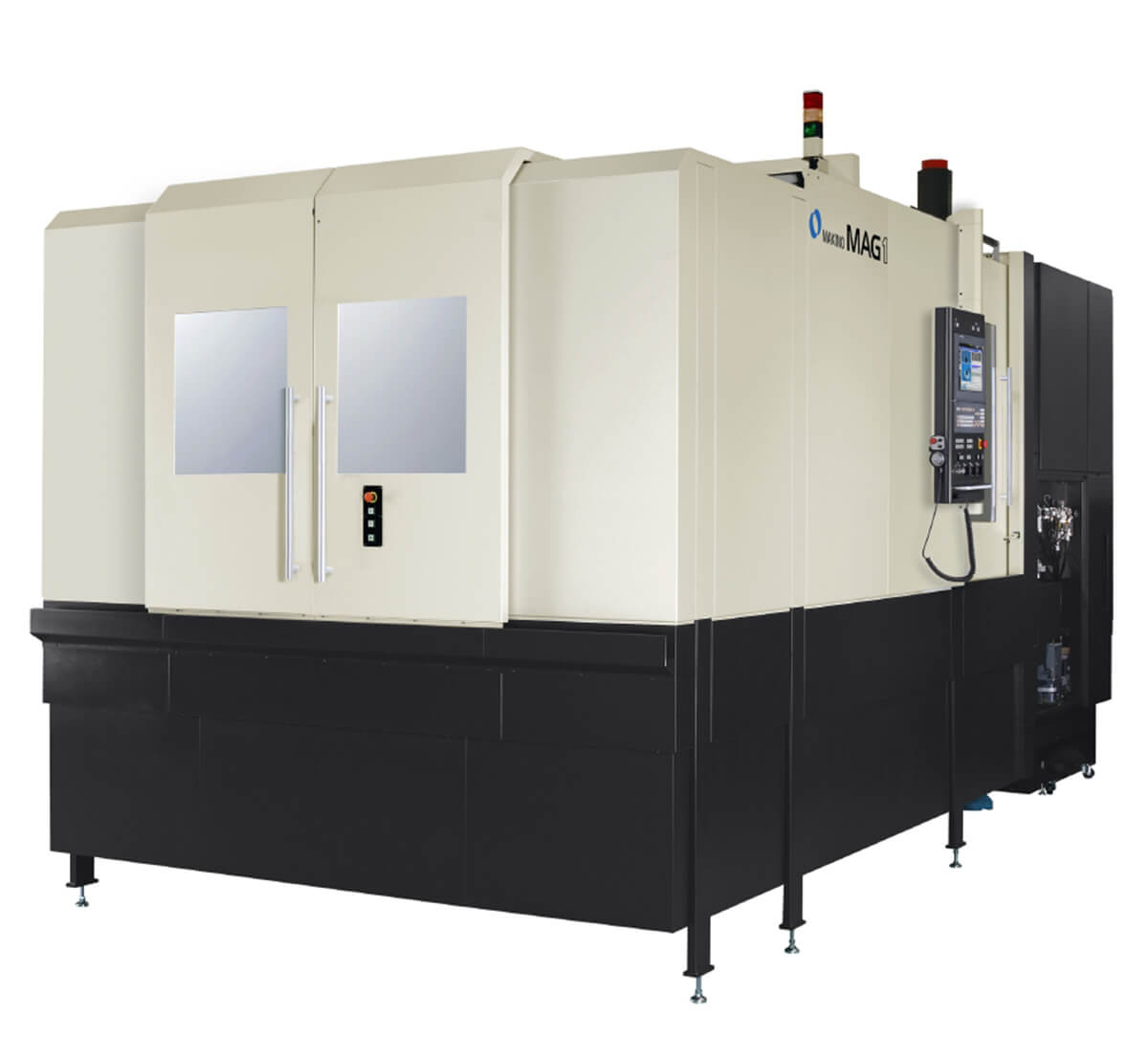

Makino MAG-Series
The Makino MAG-Series of five-axis horizontal machining centers are the ideal choice for machining medium to large aluminum airframe components. Unparalleled aluminum metal removal rates and superior chip management capabilities have raised the bar for productivity and efficiency.

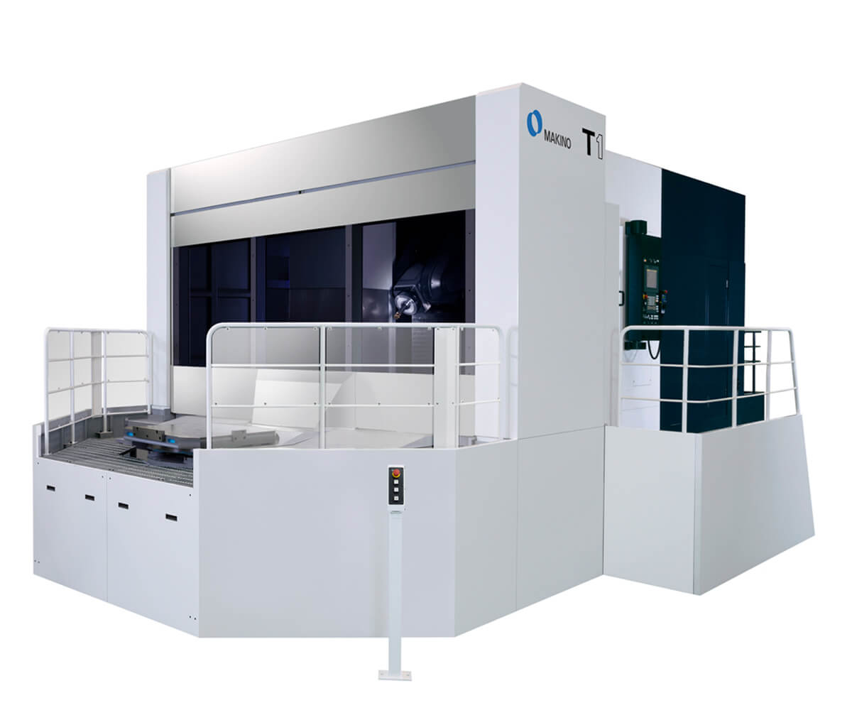

Makino T-Series
The Makino T-Series with TI ADVANTIGE™ titanium machining technologies provide four times the productivity and up to nine times the tool life over traditional titanium milling. High-volume, high-pressure cooling draws heat away from the titanium, supporting the integrity of the cutting tool.  The series features a unique combination of high range of axes motion and active dampening technologies.

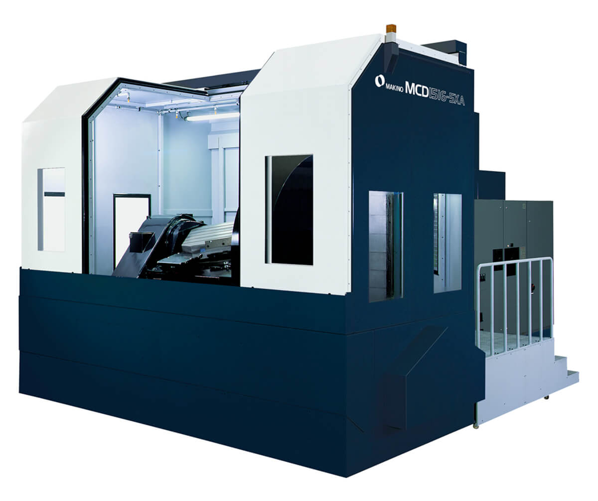

Makino MCD-Series
Featuring counterbalanced box way-style construction, the Makino MCD-Series are designed for large machining of hard metals such as stainless steels and titanium for the aerospace industry and other complex applications. These trunnion-style Five-axis horizontal machining centers are supported by a range of spindle offerings, and unique dual-driven rotary axes let you do high-force machining with the rotary in motion.
